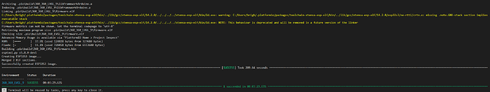

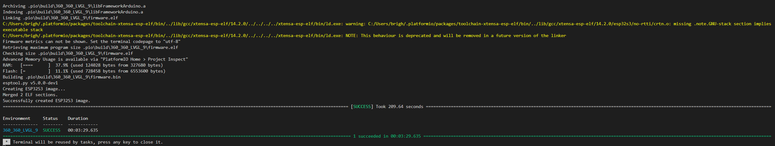

I get a warning from the GCC compiler:
missing .note.GNU-stack section implies executable stack

Without a flag, the warnings are like this:

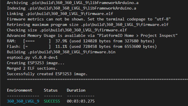

With flag no warnings
  -Wl,-z,noexecstack
