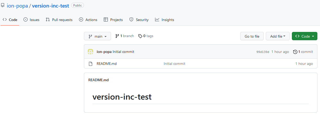

This repo is empty.
Sorry, forgot to push. It’s there now.
