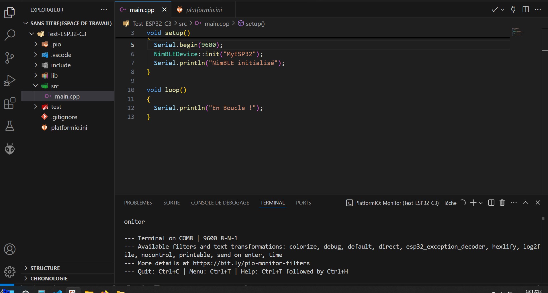

How to display messages in monitor (like Arduino-IDE) with VS-Code + PIO, I got this :
but in the TERMINAL nothing from my serial.print … Is there a way to display an external windows with output message on it ? Thanks !
The Serial object can point to two different things:
  • Serial0 aka HardwareSerial aka UART port
  • USBSerial aka HWCDCSerial aka the builtin native USB port
So try
  -DARDUINO_USB_CDC_ON_BOOT=1
  -DARDUINO_USB_MODE=1
to route the output of Serial to the native USB port.

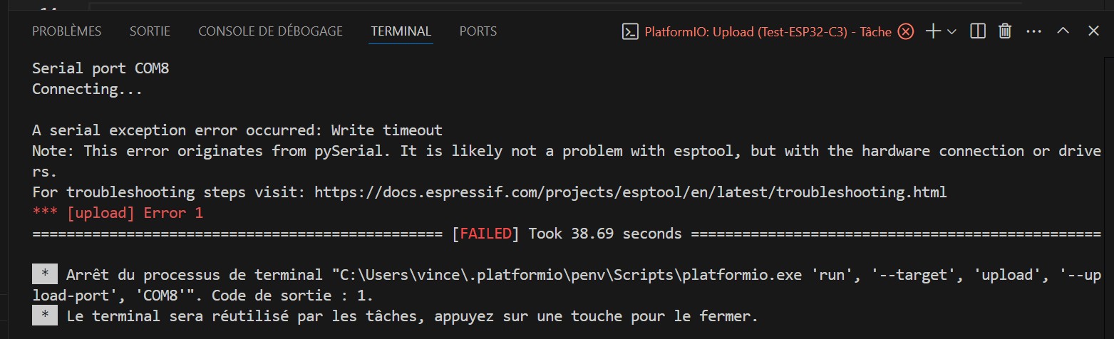

Hello and thanks after .ini modification I was able to compile & run one time, with correct output on TERMINAL windows, now after modification of the loop, I get a compilation error with strange message ?

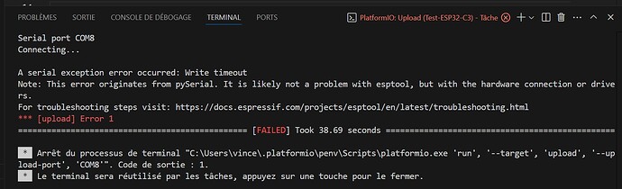

Upload Error !

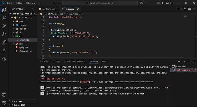

I try to fix it with modifying ini file :
[env:esp32-c3-devkitc-02]
board = esp32-c3-devkitc-02
lib_deps = NimBLE-Arduino
upload_port = COM8
monitor_port = COM8
Then the main.cpp :
#include <NimBLEDevice.h>
void setup()
  Serial.begin(9600);
  NimBLEDevice::init("MyESP32");
  Serial.println("NimBLE initialisé");
void loop()
  Serial.println("Loop started ...");
Any idea ?

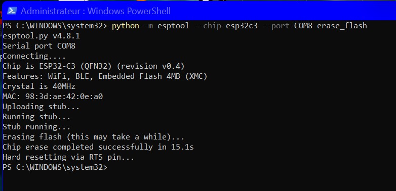

removing build-flag then return back error still the same :
Seems PIO for ESP32-C3 or C6 is not the good tool, a simple code hang-up it and only solution is to erase the flash :

This is not a “compilation” error. This error is about opening the COM port.
The C3 and C6 are a bit tricky to handle because of their native USB port.
In contrast to UART (USB to Serial), the serial connection to a native USB port is disconnected when the ESP is restarted. As a result, the COM port on the computer disappears briefly and may reappear under a different COM port number. This makes handling somewhat more difficult than, for example, with an ESP32 that is connected via a USB 2 serial chip.
You did not specify the version. Which platform32 version do you actually use?
