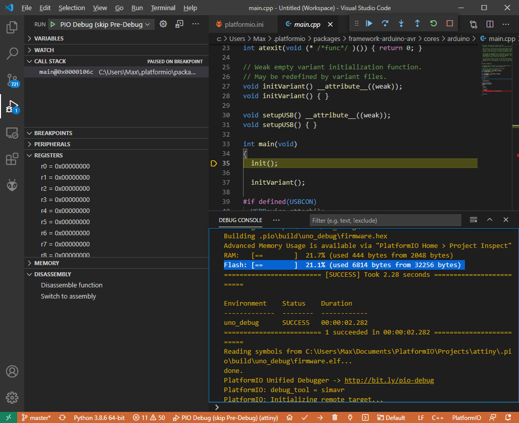

Found it!
Both “Inspect” and “Debug” options by default DO NOT use [env:debug] but instead use the normal release environment, for me in this environment this is [env:nanoatmega328] so when I add the debug build flags while keeping the build_type = release like this
Then the result is both a working inspection without [checkprogsize] error AND a working debugger on simavr!
Only remaining open question: why does [env:debug] neither affect Debug nor Inspect by default and how do I change that?
