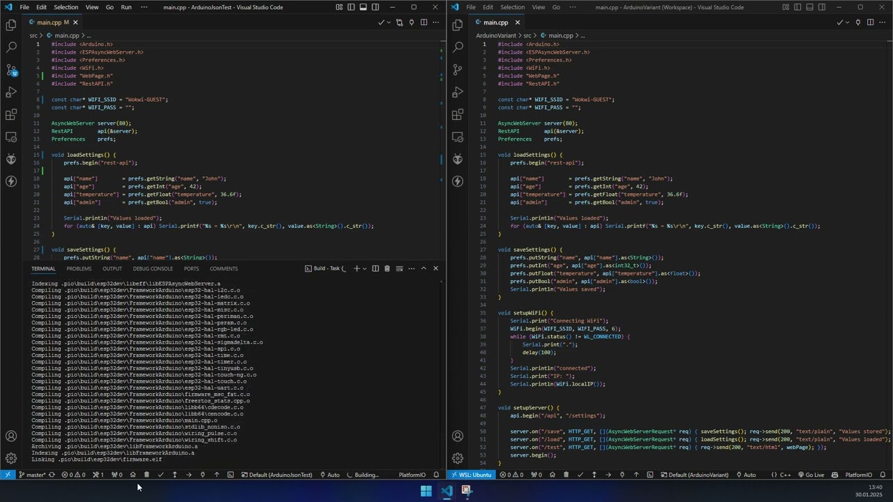

You should consider to switch over to Ubuntu in WSL (Windows Subsystem for linux). The build time is much faster - depending to the project sometimes incredible fast :slight_smile:
On the left: Windows
On the right: Ubuntu in WSL

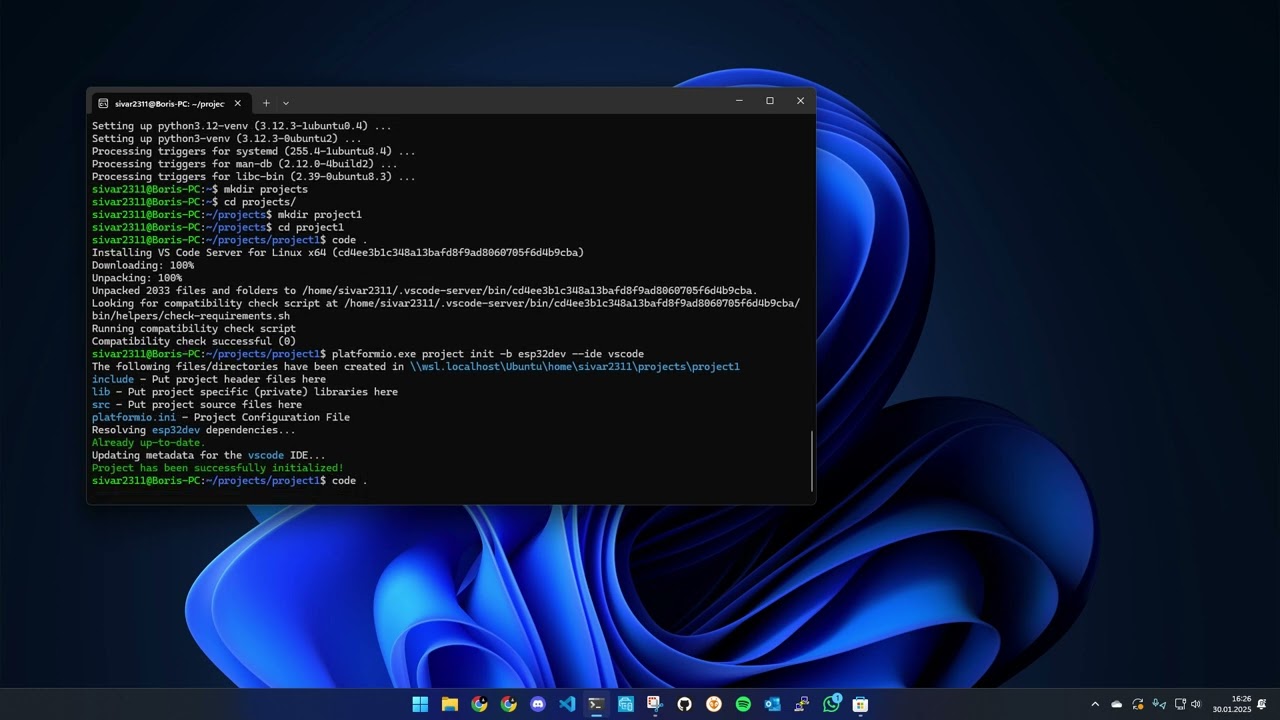

Installing Ubuntu in WSL and setting up PlatformIO is an easy task:
