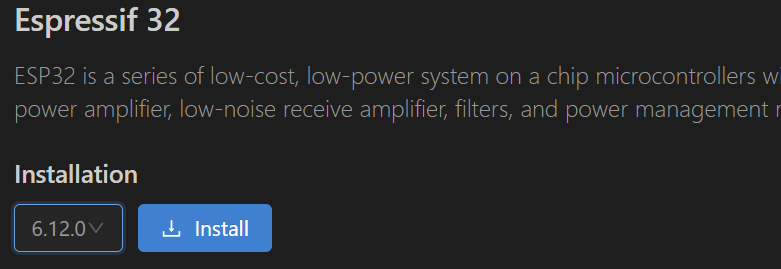

Have a working Espressif 32 platform 6.11.0 environment on Windows ARM64 (Surface computer) Just updated to 6.12.0 and it broke. I suspect a new package is introduced that does not support ARM64. See output below:

Reverting to 6.11.0 worked to get PlatformIo running again.
