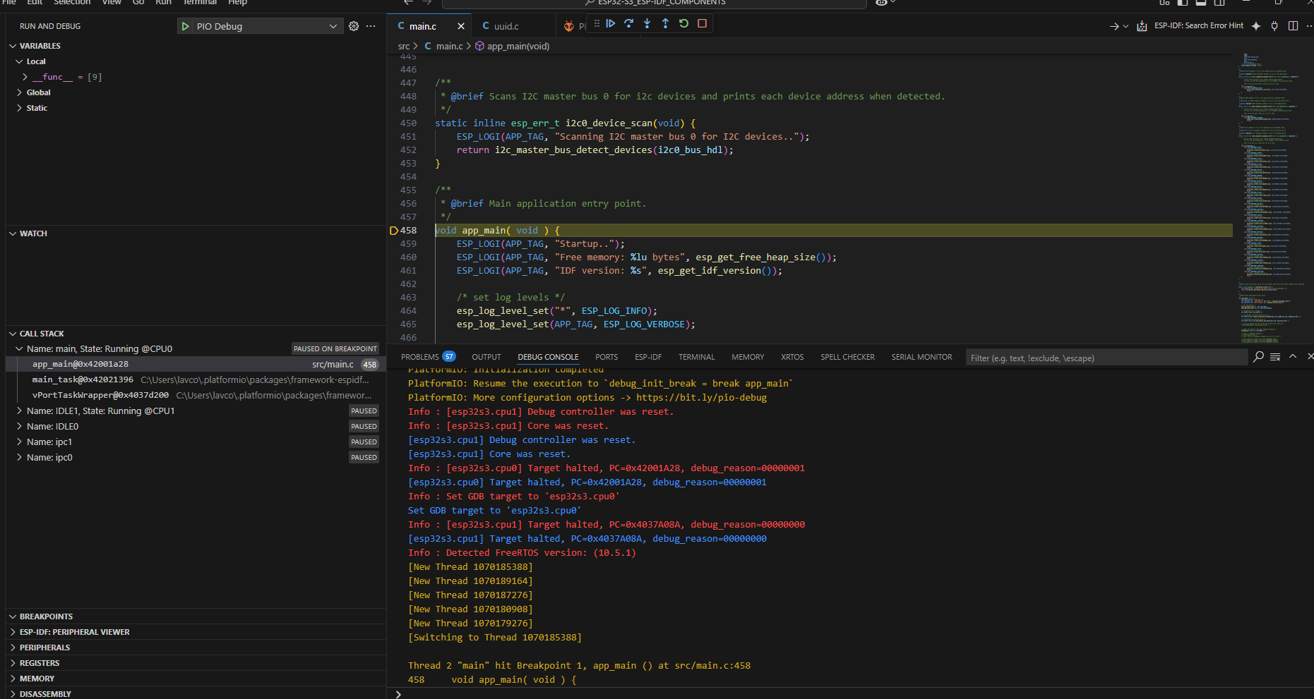

I am using the esp-idf framework with PlatformIO and VS-Code, and my .ini configuration is similar to yours. However, in my case, I have it set to break when it hits the ‘app_main’ function. See screenshots.

debug_init_break = break app_main
debug_tool = esp-builtin

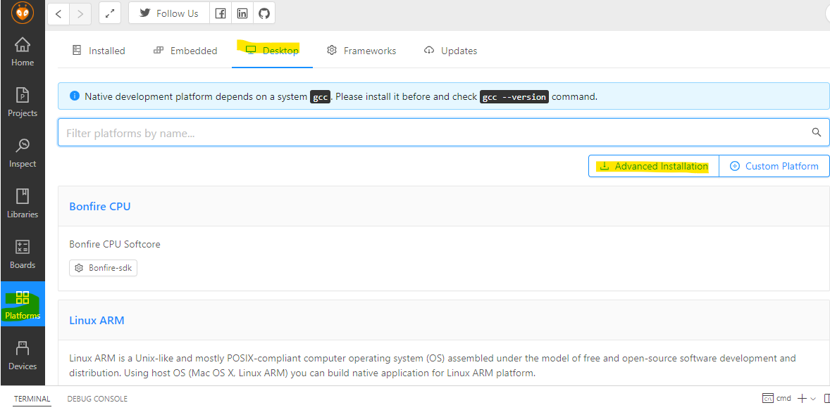

I had to remove any “Espressif 32” related platforms at Pio Home > Platforms > Installed tab. Then, at Desktop Tab, hit Advanced Installation, pasted @jason2866 's link and Install.
