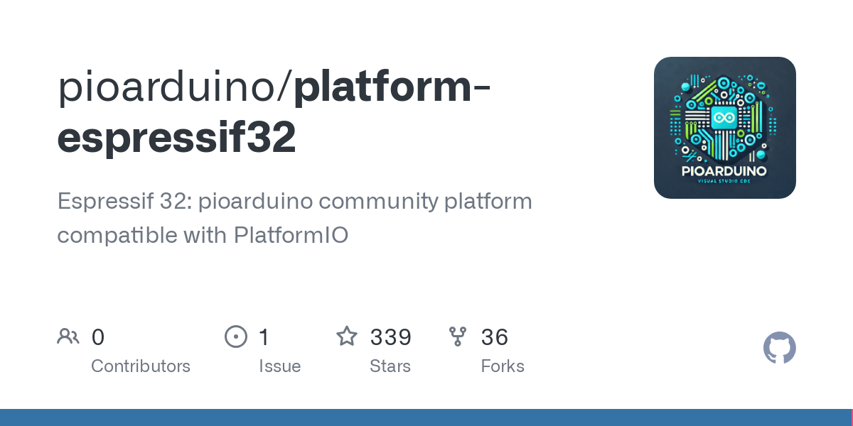

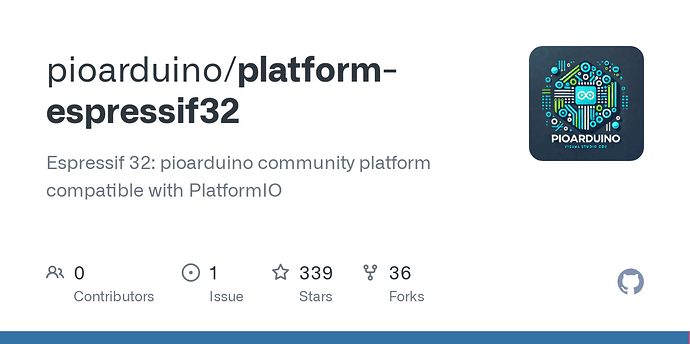

Sure you can, but if you’re targeting the esp32-hal-timer.h version as found in Arduino-ESP32 3.x instead of 2.x, you will need to upgrade your platform.
