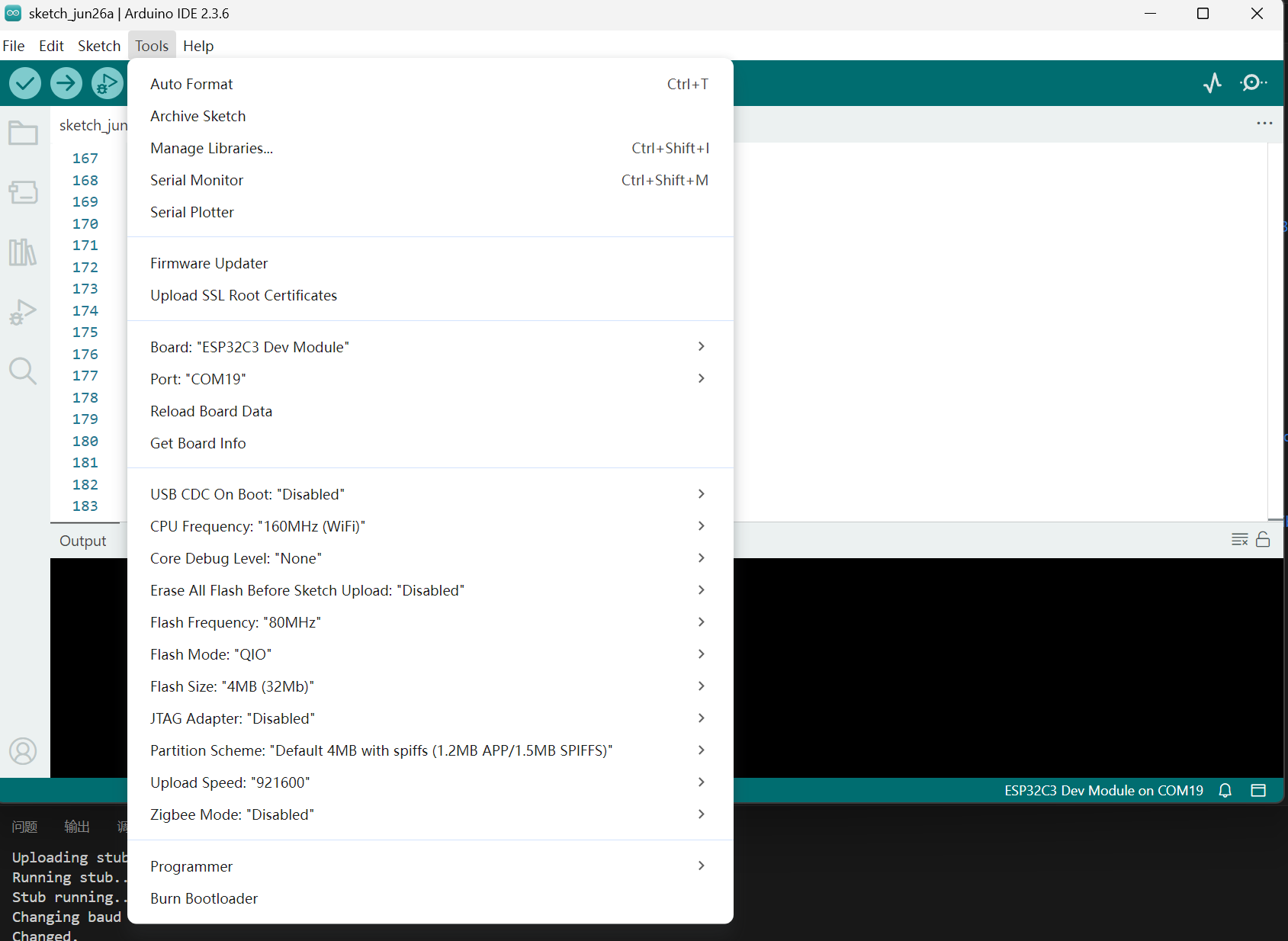

BTW: I don’t think that PlatformIO is causing the issues. Do you have the same issues when using ArduinoIDE? (Just for double checking)
Download succeded when using Arduino IDE
Does the issue still happen after reinstallation of PlatformIO?
Please also show a screenshot of your ArduinoIDE Board settings.
Re-installing PlatformIO solved the problem, at least for now.
