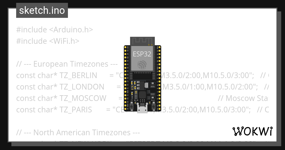

I have no problems here. See
Choose your timezone in line 28 and run the simulation.
