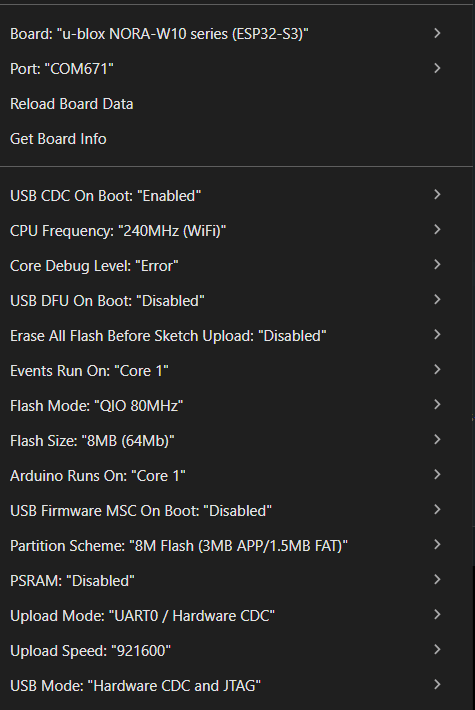

Hello, I’m programming a custom board through USB CDC connected directly to pins 23 and 24 on an ESP32-S3-MINI-1-N8.
After pulling the boot pin low and toggling reset, the COM port appears and I can upload a program using the Arduino IDE. I can then reset the chip and my program prints to the COM port as expected.
When I perform the same steps using my PlatformIO project, the program uploads successfully, but the COM port does not reappear after I reset the chip.
Here are the settings used in the Arduino IDE:

You did not specify the platform version.
Which Espressif Arduino version do you use in Arduino IDE and which version do you have installed in PlatformIO?
For the Arduino IDE, it works with both 3.2.1 as well as 2.0.17.
For platform IO, I have now specified
platform = espressif32@6.11.0
So I’m not sure which version I was using before, but I get the same results with 6.11.0
I think your memory_type is wrong.
Assuming your board has QIO Flash and OPI PASRAM this setting must be
board_build.arduino.memory_type = qio_opi
To get Arduino 3.2.1 and to rule out other sources of possible errors, please use this platformio.ini:

Manually updating to 3.2.1 fixed the issue!
Thanks! you’re awesome.
