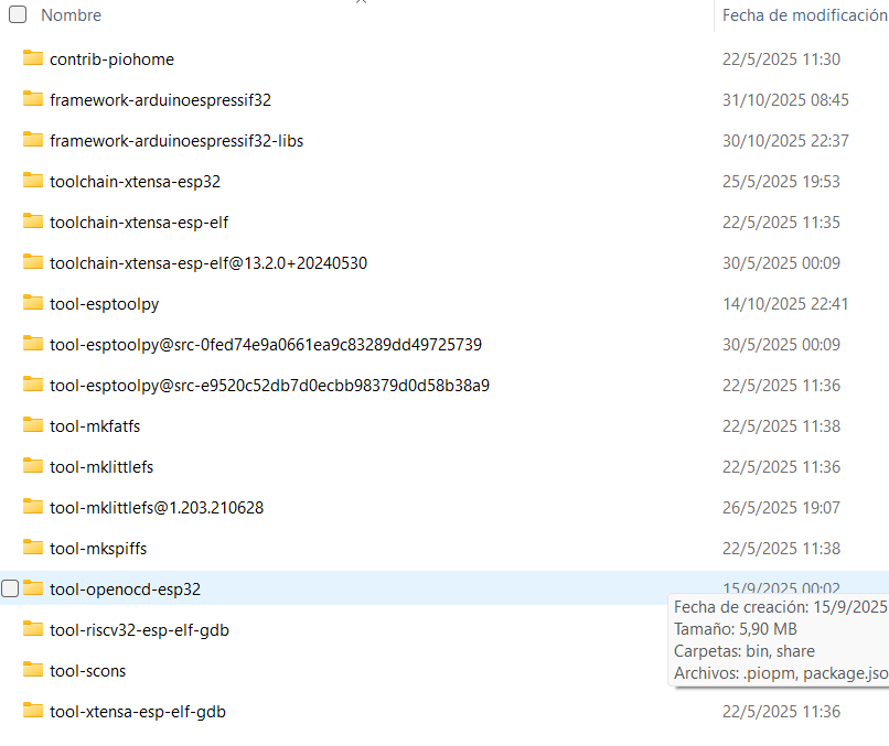

I see these files in the folder, the deleted files were not reinstalled.
Sorry, deleted also those files beginning with “framework…” restart VSC and works.
