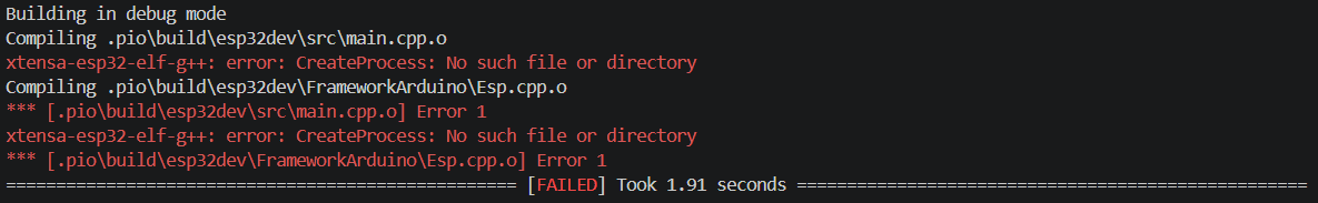

ESP32 Dev Module — Build Fails with “CreateProcess: No such file or directory”
I’m working on an ESP32 Dev Module project in PlatformIO (VS Code). This is my main project code, not a test project, and the build consistently fails with the following error:
Details:
  • Board: esp32dev
  • Framework: Arduino
  • PlatformIO version: latest (clean reinstall)
  • Toolchain: toolchain-xtensa-esp32 @ 8.4.0+2021r2-patch5
  • OS: Windows 11
  • I already checked PATH, deleted/reinstalled the toolchain, and cleared .platformio\.cache.
Despite this, the error persists. PlatformIO seems to locate the toolchain, but Windows cannot launch it.

PlatformIO on Windows 11 fails to compile ESP32 projects with CreateProcess: No such file or directory, even though the toolchain exists and runs manually. All standard fixes (reinstall, PATH, permissions, shell, environment reset) have been attempted without success.
