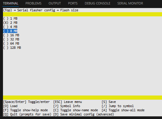

Since it is an espidf project, the flash size has to be set in sdkconfig
I was banging my head against this for ages. Updating the flash size wasn’t working for me. I just created a repo that works on my machine:
I’m not sure what made it work though, specifically… so just sharing a working solution in case someone else needs it.
Follow up: can the default sdkconfig for the ESP32-C6 be updated so that it doesn’t default to 2MB flash size? Where would that be / how does that work?
Open a terminal and run pio run -t menuconfig
Navigate to “Serial flasher config” / “Flash size”, select the desired size (up / down / spacebar). Don’t forget to press S to save and Q to quit.
I more so meant the default that is set when you create a new project in PlatformIO :slight_smile:
