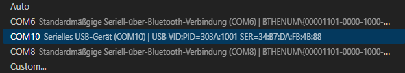

When you click the serial port selector you should see something like this:
COM<X> Serial USB-Device (COM<X>) | USB VID:PID=303A:1001 SER=XX:XX:XX:XX:XX:XX
I’ve tried the sketch on my ESP32-C3 super mini using the platformio.ini from above and it works perfect - no issues.
OMG Boris, you’re right again !!!
