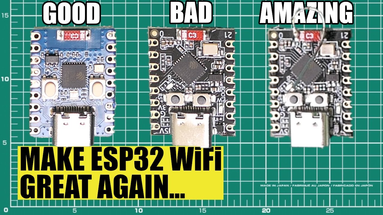

Take a look at this video for detailed information and hardware fix:
