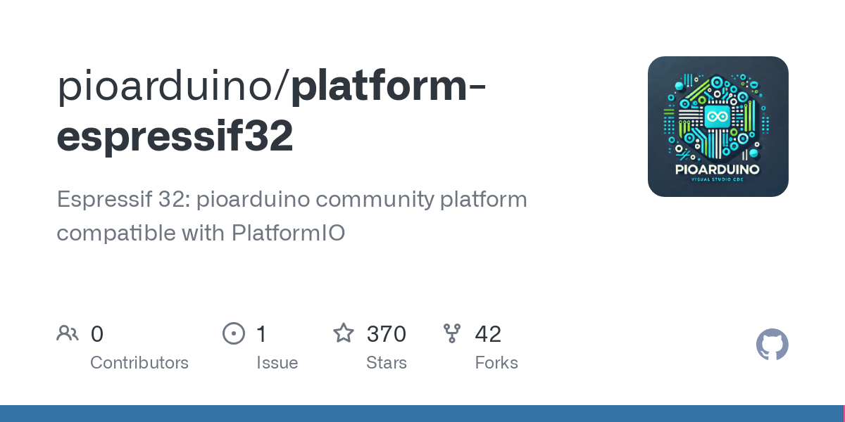

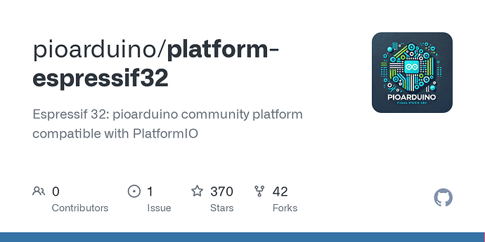

The latest available stable version provided by pioarduino is Espressif Arduino 3.2.0:
platform = https://github.com/pioarduino/platform-espressif32/releases/download/54.03.20/platform-espressif32.zip
The latest available alpha version provided by pioarduino is 3.3.0-alpha1:
platform = https://github.com/pioarduino/platform-espressif32/releases/download/55.03.30-alpha1/platform-espressif32.zip
Usually pioarduino releases the latest version shortly after they are released by Espressif.
See here the available releases by pioarduino:

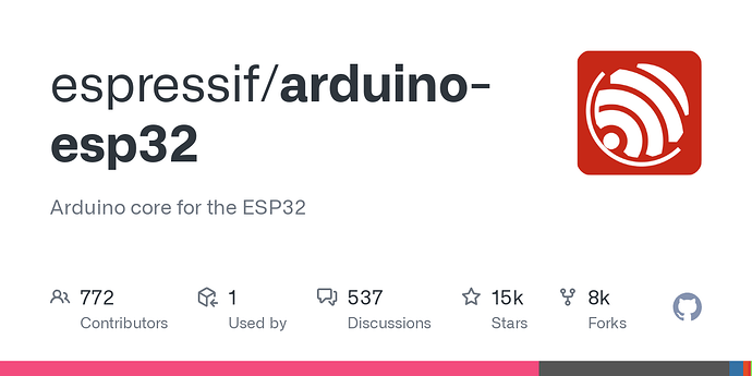

See here for the releases by Espressif:
(pioarduino wraps the releases by Espressif in a platform which can be used in PlatformIO)
