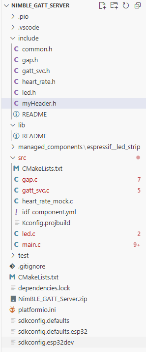

My project folder structure looks like this:
I’m sure I’m missing something really obvious - any input gratefully received!
