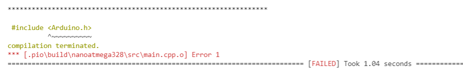

This is the result I get
If i change the framework-arduino-avr (which does not exists) to framework-arduinoavr the .vscode faults disappears. But the include error is still there.
