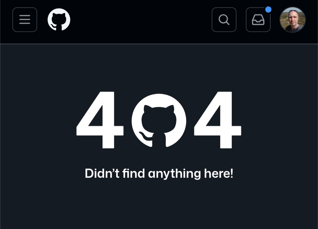

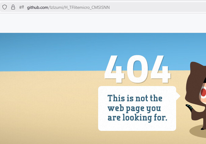

Yeah that one’s a 404 not found.
I already made it public, I don’t understand why you can’t access it :((

Even the username cannot resolved! Typo?
