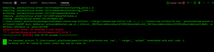

Hello, I am getting an error when attempting to upload the following code to my esp32cam board. The goal is to leverage an Asynchronous webserver along with a websocket to control the cam via wifi. I have attached the error message and code as follows:

platform.ini:
[env:esp-wrover-kit]
platform = https://github.com/pioarduino/platform-espressif32/releases/download/54.03.20/platform-espressif32.zip
board = esp32cam
	yoursunny/esp32cam@^0.0.20250112
    C:\Users\enver\Downloads\AsyncTCP-master.zip
	C:\Users\enver\Downloads\ESPAsyncWebServer-master.zip
Thanks for the help!
Wherever these are taken from and whatever their versions might be…
Does it also happen when you use the latest available version of the “offcial” ESPAsyncWebServer?
[env:esp32cam]
board = esp32cam
  esp32async/ESPAsyncWebServer@^3.7.7
AsyncTCP is listed as dependency and the correct version will be installed automatically.
That worked perfectly thanks!
