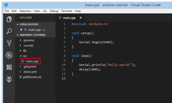

Could you share the project folder structure?
A standard PlatformIO configuration, like the one shown in the tutorial example, looks like the setup in this screenshot.
Is your project folder named “Common”?
Looking at the error message, it appears the builder recognizes the project folder as:
/Projects/DPLHInternal/DALFiles/Components/BuiltinLed
