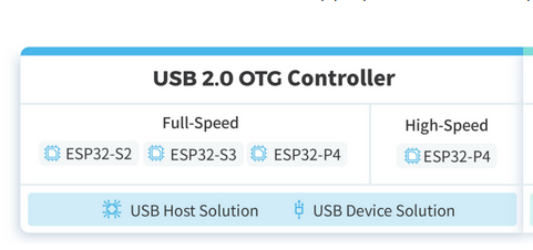

The old, original ESP32 has no USB support. It has no USB peripheral in the microcontroller. You cannot use Adafruit TinyUSB with it.
Other ESP32 chips do have support.
grafik
With those, you can use the USBMIDI.h built in library.
These devices are not compatible.
