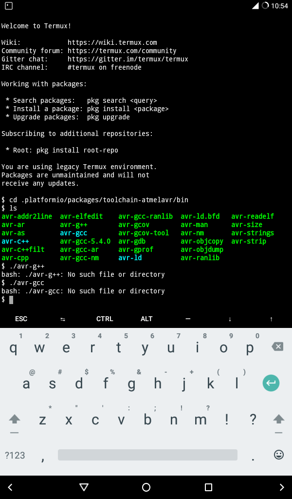

Thank you very much for your reply. When I tried to exrecute the binary as you said, this happened
The same happened with newer binares (1.70300.191015 a.k.a 7.3.0)

You need to do a ./avr-g++ --version otherwise it will attempt to execute the system installed one in the PATH, which doesn’t exist.
