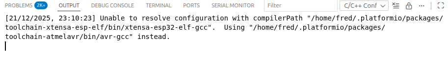

after a few month of absence using it I’m getting the following error message when starting vscode:
What would be the proper steps to correct the error - or can I just continuing using and compiling my project(s)?

PlatformIO regularly self-destructs. The ‘solution’ is to nuke ~/.platformio (mv it away if you’re not YOLO about such things) and let it re-download all of its python internals. We see this on all three desktop-ish platforms in this group on a regular basis. Something about its own updates seems to trip it up.

I did as suggested.
However, on restart, it still shows the same messages as before.
I guess I have to figure out which project is referring to the “missing’ compiler and start there.

Mabye pio run -v will tell you more about what it’s trying to run or why. You might have to tear into the python itself and try to understand what it’s looking for or why it’s not finding it. Maybe there’s some science to that beyond sticking print calls all over the place; I could never make the python debugger work.
