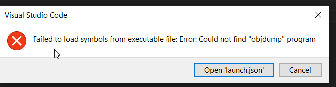

we integrated our own platform for a PSoC4 device and are using the IAR compiler from EWARM 8.50.9. Unfortunately, the debugging is working with PlatformIO version 6.1.9. When using a newer version, we receive the following error when we start the debugging:
There is a small workaround with renaming the ielfdumparm.exe to ielfobjdumparm.exe. With this workaround the debugger starts at least, but the debugging itself is not trustable. Do you have any idea or hints how we can fix this error? It seems that the platformio Core requests a xxxobjdumpxxx.exe.

Strictly speaking, PlatformIO doesn’t require the objdump binary. The dependency on objdump is imposed by the C/C++ extension from MS that uses it internally for several GUI views. From what I understand, this extension expects the binary name to follow a specific convention, which would explain why renaming the objdump binary allowed the debug session to start. Could you please provide more details what exactly differs when you use PIO Core v6.1.9 and a newer version with renamed objdump binary?

Debugging cannot be started with the error message that the “objdump” program cannot be found. By adding a program to the folder where the binaries of the compiler toolchain are located, debugging can be started. However, the name of a program in this folder must contain the string “objdump”. Setting and hitting breakpoints is now possible, but symbols are either not resolved at all or not displayed correctly in the debug view. Additionally, the code cannot be displayed in “Assembly”.
Cause:
In the .vscode folder, there is a “launch.json” which contains information about certain debug configurations. The parameter “toolchainBinDir” provides the ability to specify a path where programs needed for debugging are generally located. This “launch.json” is generated by the PlatformIO Core. The basis for the generation is a “launch.json.tpl”, in which the “toolchainBinDir” parameter is set. Here, there is a significant difference between PlatformIO Core version 6.1.9 and newer versions like 6.1.18. In version 6.1.18, the variable “cc_path” is found in line 19 of the mentioned file. In version 6.1.9, the variable “gdb_path” is found in line 20. The paths behind these two variables can be easily seen in the Core in builder\tools\piointegration.py, where both variables, “cc_path” and “gdb_path”, are assigned values in both version 6.1.9 and version 6.1.18. As can already be guessed, “cc_path” is assigned the path to the folder where the C compiler is located, specifically the path where the program set for the global “CC” variable is located. The same applies to the “gdb_path” variable, except that here the path to the folder where the GDB client is located, or the program set for the global “GDB” variable, is used.
