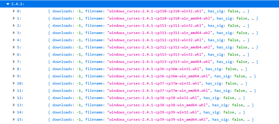

https://github.com/platformio/platform-espressif32/issues/1213 suggests that maybe the windows-curses project does not yet have a prebuilt package for your used Python version.
Per https://pypi.org/pypi/windows-curses/json the prebuilts are available for Python 3.6 up to Python 3.13.
If you’re running Python 3.14 you’re depending on

    ERROR: Could not find a version that satisfies the requirement windows-curses>=2.4.1; sys_platform == \“win32\” and python_version >= \“3.13\” (from esp-idf-kconfig) (from versions: none)\r
    ERROR: No matching distribution found for windows-curses>=2.4.1; sys_platform == \“win32\” and python_version >= \“3.13\”\r
    *** Error 1\r
    Installing windows-curses package\r
    ERROR: Could not find a version that satisfies the requirement windows-curses (from versions: none)\r
    ERROR: No matching distribution found for windows-curses\r
    *** Error 1\r

CC @ivankravets, did the default bundled Python environment get to updated to 3.14 somehow? This is now the second case. Or
The for espidf required windows-curses Python depedency is not available for Python 3.14 yet.
The 3.11 is the default Python interpreter
There are multiple incompatible packages with Python 3.14. Some users prefer to always use the latest software, and that is the root of the issue. They manually install custom Python.
But this is the used Python executable, which seems like the proper one in penv, and it still reports as 3.14-2?

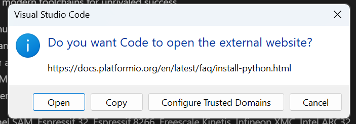

I’m a little confused now, as when I reinstall PlaformIO it’s asking me to go to the Python site and install Python exactly as I did to begin with…
Ok, new installation, now with 3.11. Looks like my Toolchain count went up. I think that’s what we’re after:

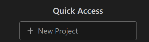

I’m trying to create a new project via the Quick Access “New Project.”
Not sure how I’d be able to create a commit on a file that hasn’t been created yet…
