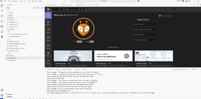

We’re missing something else… because this doesn’t solve the problem for me.
I changed the line to use <comms.h>, and get the exact same error.
(sorry, I don’t know how to do a record of the window, but here is a screenshot of the VS Code window after the change, with the same compile error.)
Is there a PATH, or some other setting, that I’m missing?
I updated the repository as well, but the only change was that single line.
Do you have the same error on a brand new and clean project?
I’ve got the feeling that this error does not come form the library but from a broken platform / package!

I deleted the folders and restarted VS Code, which then attempted to reload the packages and platforms.
There was a “MissingPackageManifest” error at the end of the reload (see below).
And I’m still getting the same error message.
Repeat deleting the folders but also delete the .cache folder.
Still didn’t help. Got the same error message at the end of the reinstall process… (see below)
