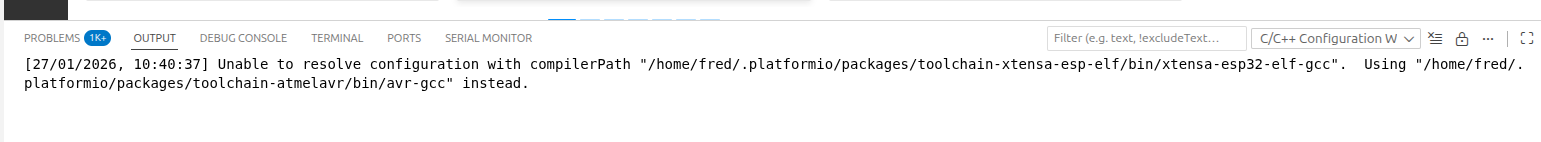

I’m asking because I’m getting a message when starting VSCode.

So there must be somewhere in my ‘settings’ (projects) a reference to the [toolchain-extensa-esp-elf].
I create in the past (approx 6 month ago) some small projects for the ESP32 for testing reason. And as I remember they went smooth and compiled w/o any problems. But what I don’t understand is that this compiler is now missing.
When compiling one of these projects I’m receiving now compile errors.
How can I fix that problem?
