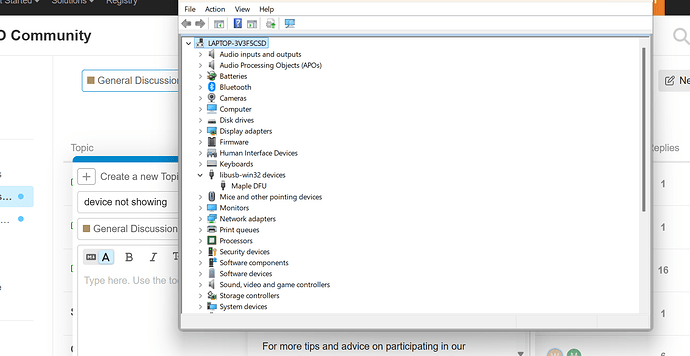

Device not showing
how do i access this?

in the above picture lib usb32 devices i want to access maple dfu which is bluepill stm32f103c8t6
but it does not have a com port ,
what to do ?
