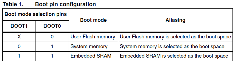

When BOOT0 (BT0) pin is HIGH (“1”, 3.3.V), and BOOT1 is 0, then the device will boot from “system memory”, which means DFU bootloader.
When BOOT0 pin is LOW (“0”, GND), it will the firmware you uploaded.
