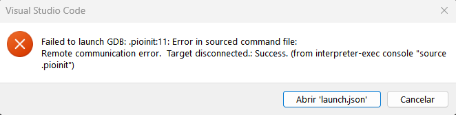

Hi. I am trying to debug with platformio, and, although I have followed this steps Debugging with PlatformIO: Part 1. Back to the Basics | PlatformIO Labs, I am getting this error:
Is it possible to debug with all esp32 boards?
The error message:

.pioinit:11: Error in sourced command file:
Remote communication error.  Target disconnected.: Success.
