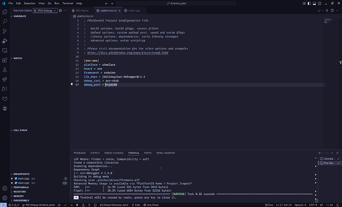

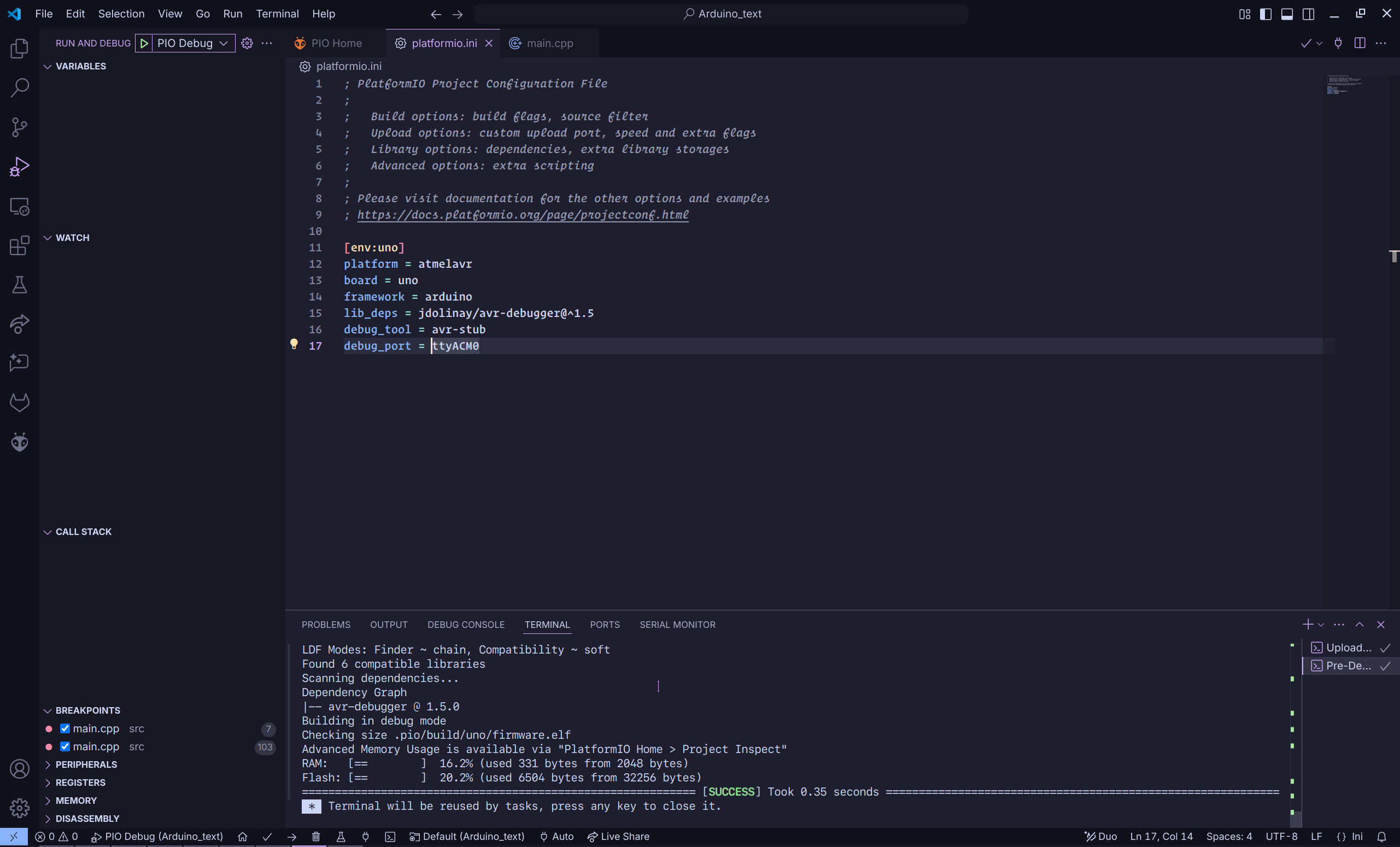

I have arduino uno board with attached funshield and I would like to use the avr-debugger with it. Unfortunately, it does not seem to work.
When I hit debug, the debugger starts loading but then ends and nothing happens. I dont see my variables, nothing. Just a blank screen here:
I have tried both calling breakpoint(); manually and using the red dot. Nothing worked.
For reference, I am adding my source code file and my platformio.ini file.
Any help would be appreciated.
