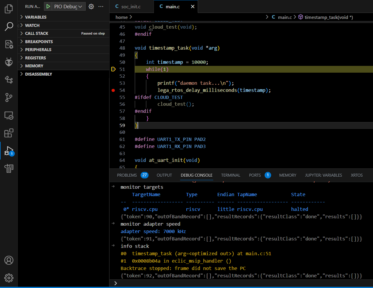

press f10 takes seconds to next line!!
eg:
from line51 to line53
possible reasons?
