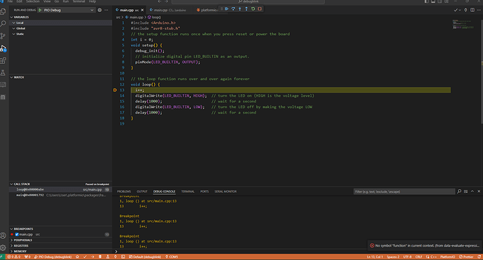

Hi, i get the debugger to run on my mega2560. it reaches the breakpoint. i break at a instruction i++ (declared as int). i can not see the value of i when the program breaks.
What must i do to see the variable values.

My ini file looks like this
this is my simple sketch

i want want to see the value of i
