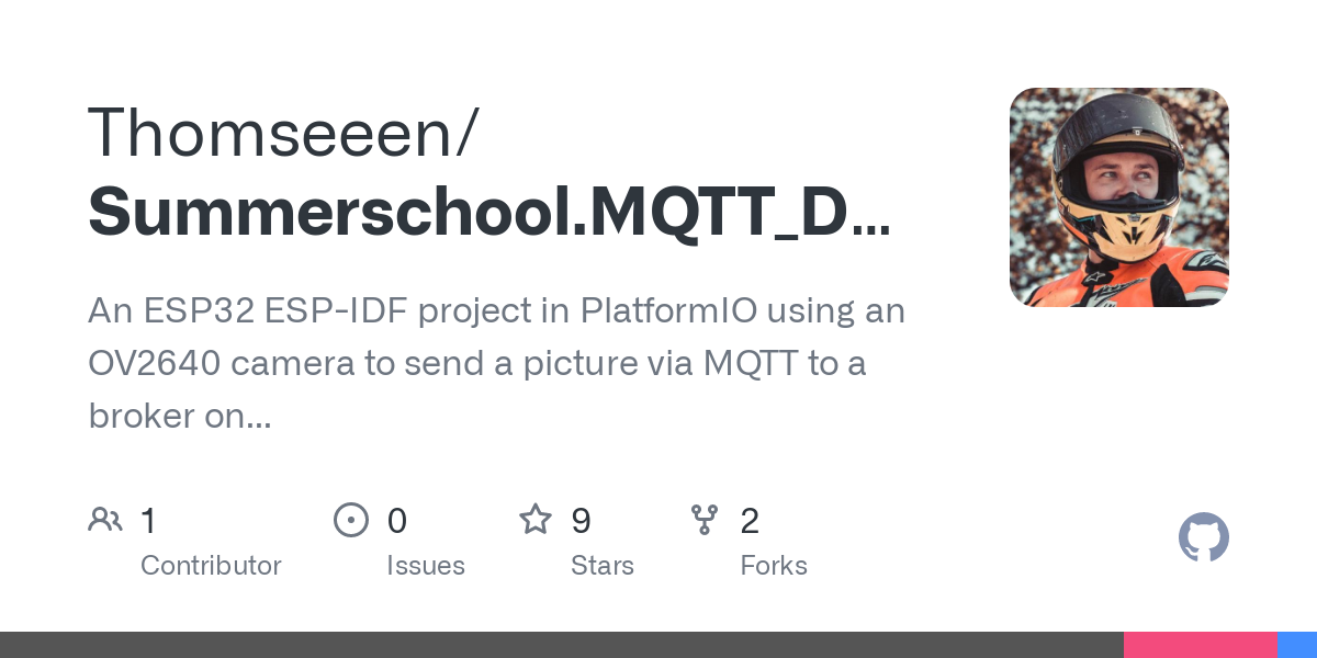

That depends on what exactly you want to achieve. Using PIO means you have to do a lot more manual work than using Mongoose OS. To give you an example:
I wrote a MQTT-app for an ESP32 with an OV2640 camera that publishes a timestamp and picture on a button press - A doorbell with camera:
The timestamp and picture gets sent via MQTT (TCP/IP) to a broker on my computer. That broker comes with a dashboard that can be called via your browser which shows you all connected clients, incoming bytes, timeouts, etc. :
