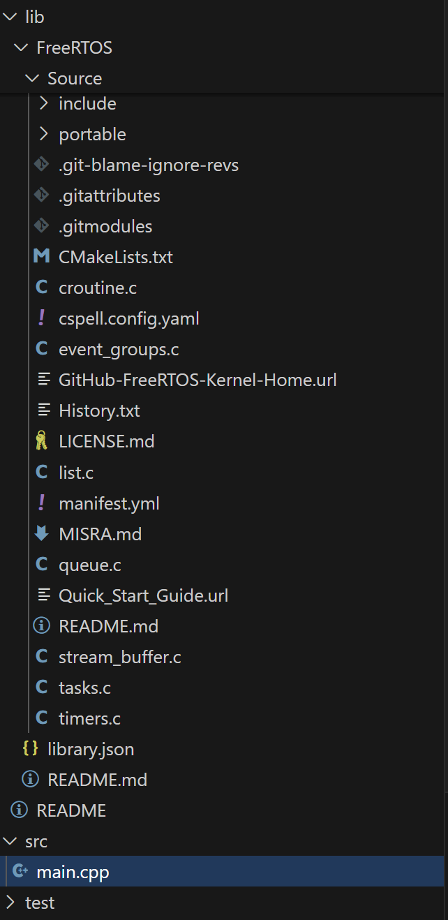

Here is my folder setup:

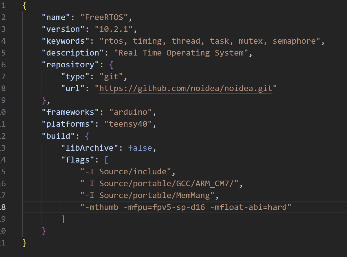

The library.json:

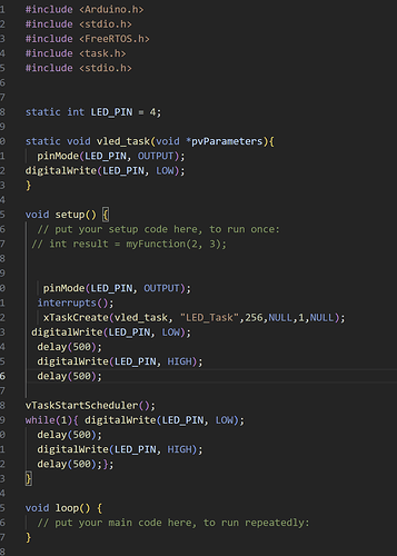

and the main.cpp script:

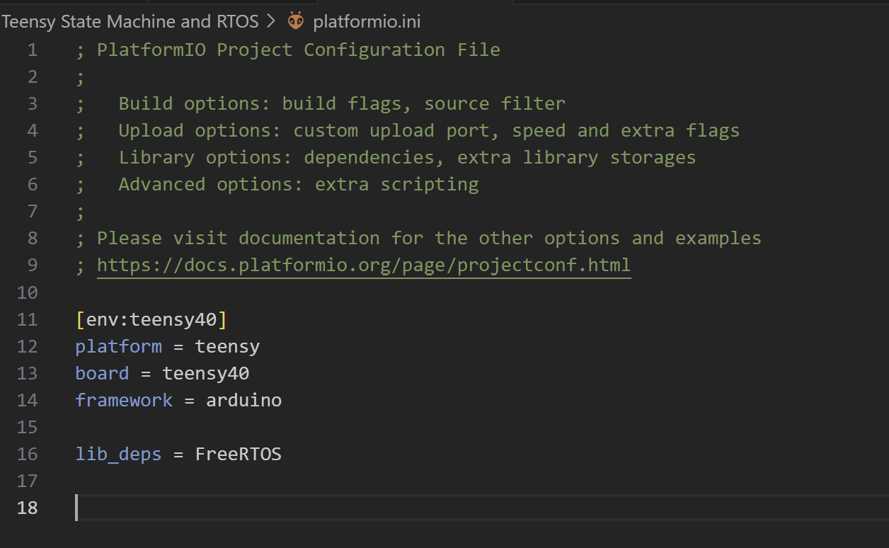

And also platform.ini
FYI, the Teensy4 can host a GDB server via serial, which PlatformIO can connect to. This would enable you to do line-by-line debugging.
https://github.com/ftrias/TeensyDebug#installing-for-platformio
Step into the vTaskStartScheduler() and see if the apprpriate interrupt functions are entered for the systick handler, the SVC_Handler, PendSV handler et cetera.
Especially take note that you have to tell FreeRTOS the name of these interrupt functions so that they’re called in the way the Teensy startup assembly file is expecting them to be. For example, for STM32 and the standard CMSIS names
but the Teensy 4 startup and vectors is special in the sense that the interrupt function is called differently and already implemented by the EventResponder system. See
Exception numbers “14” = PendSV, “15 = SysTick”, “11 = SVCall”, see https://developer.arm.com/documentation/dui0646/c/The-Cortex-M7-Processor/Exception-model/Exception-types.
Since FreeRTOS does need to be called by a timer (e.g. SysTick, but could also be any other hardware timer) and the PendSV and SVC_Handler (“calls into FreeRTOS kernel code”), you’re kind of fighting against the existing implementation in the Arduino core here.
In short: This is pretty fricking complicated. If you were in a baremetal environment with no other framework code interfering, you could tell FreeRTOS to take complete control over those interrupt functions and be done.
Luckily, someone has already done all the hard work hacking the interrupt handlers to call the FreeRTOS code and not break the existing Arduino code, with stuff like
So, I see no point in what you’re trying to do manually, you should use that existing library.
