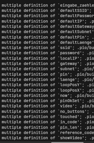

Compile FAILED but no Problems shown
instead I get a lot of yellow lines

can not find any of the multiple definitionsons.
They areonly defined in config.h

before the last changes, quite a lot it compieled fin.
do not want to rollback a have days work.
Read the message carefully!
The messages are long, you have to scroll far to the right to see the problem.
Just a guess:
Probably you have header file which defines variables and constants and probably you include this header file multiple times.
The header file most if not all definititions are in is config.h and included nearly everywhere. in main.cpp and most other header files.
The more then 6 years platformIO is my prefered IDE for arduino nano ESP 8266 and ESP32 I never had a problem with nested includes of header files.
As I know the
#ifndef _*HEADERFILENAME_*H_
#define _*HEADERFILENAME_*H_
#endif
should prohibit those problems
This is not a PlatformIO thing but a C/C++ thing!
First you need to know the differences between declaration and definition.
A declaration tells the compiler / linker " there is something named xyz". But it does not allocate space for xyz and it does not assign a value.
The declaration is done in a header file (.h) like so:
myglobals.h:
#ifndef __myglobals__
#define __myglobals__
extern int my_global_variable;
#endif
The definition must be done in one compilation unit (.c or .cpp file):
myglobals.cpp
#include myglobals.h
int my_global_variable = 42;
Now you can include myglobals.h safely into multiple compilation units (.c/.cpp) files.
(*) The include guard (#ifndef...) only protects you to include the header file mulitple times into the same compilation unit (.c/.cpp file)
