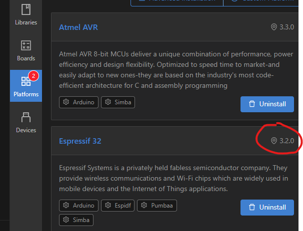

In VSC/Platformio 1.97.2, using platform Espressif32 3.2.0, I am receiving the following error messages duirng compile time. I could not find anything on the internet, that gave me a clue what is causing this:

At first glance, it looked as if there would be bugs in the WebsocketsServer.h library. However, this was hard to believe and after all it did compile fine in Arduino IDE. I had version 2.6.1 of this lib installed, both in Platformio and in Arduino IDE. After several hours of trial and error I am at the end of ideas how to solve this.
