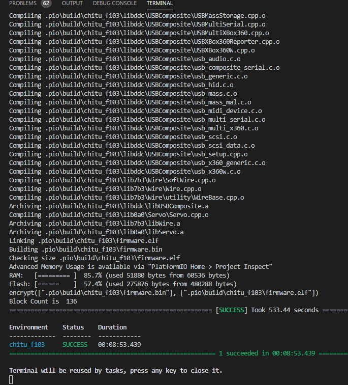

Thanks. But it didn’t work out. I will try to do something with Marlin.
You can also try and remove all previous packages and platforms in case something weird was installed.
For that, remove all folders in C:\Users\admin\.platformio\packages\* and C:\Users\admin\.platformio\platforms\* and also C:\Users\admin\.platformio\.cache.
A clen version of all needed packages is redownloaded the next time you hit “Build”.
Thank you very much! It worked!))
