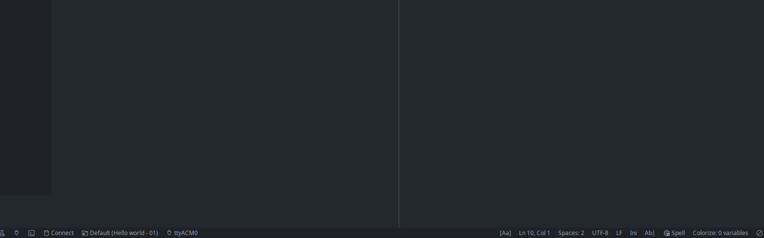

Hi a short GIF to show you results
Peek 2024-12-04 07-33
“Serial Monitor” is not part of PlatformIO.
This is a separted Plugin for VS-Code.
If you already use the builtin monitor, the COM port is blocked and cannot used by another terminal program like “Serial Monitor” plugin.

maxgerhardt Just after sending that GIF I tried as you mentioned …
Did you try selecting different available serial ports in the bottom of the VSCode taskbar?
it wasn’t set as ACM0, so i corrected that.
I then did
And you made sure to press the “Upload” button first?
And now the Serial Monitor does indeed show Hello world
