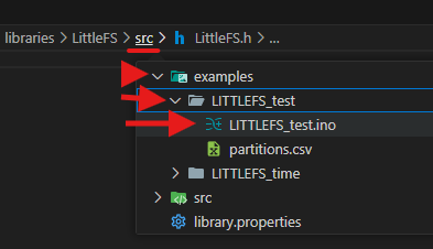

But as the code is also available on your computer, you can navigate to the example file:
Ctrl + left click on “LittleFS.h” in the #include <LittleFS.h> line.
This will bring you to the LittleFS.h source file on your computer.
Now click on src and navigate to examples / LITTLEFS_test / LITTLEFS_test.ino:
Now you can copy and paste the code from here.
