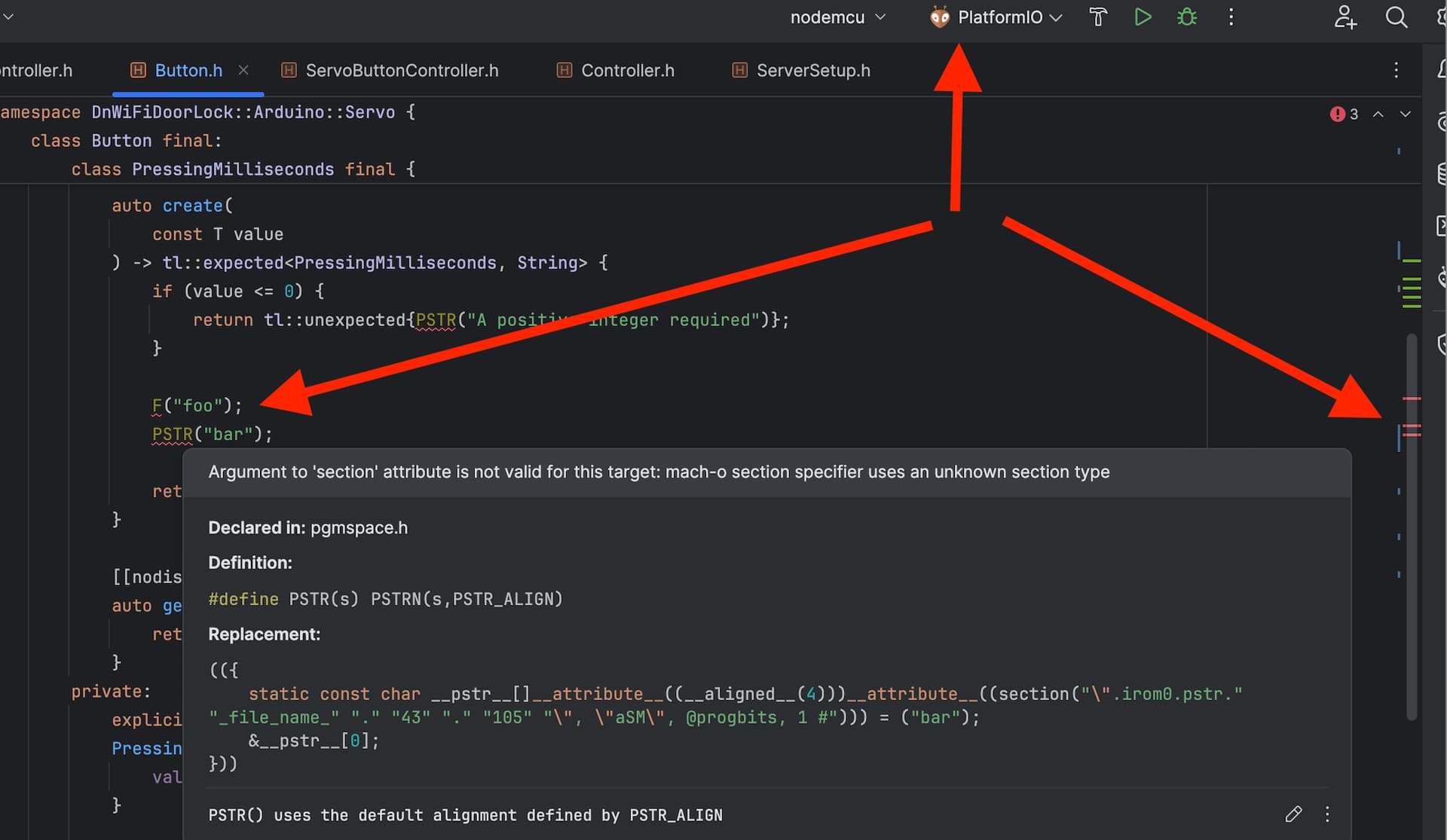

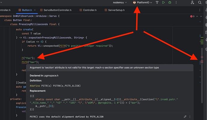

This is still an issue.
CLion 2024.3.5
Build #CL-243.26053.34, built on March 20, 2025
Runtime version: 21.0.6+8-b631.39 aarch64 (JCEF 122.1.9)
VM: OpenJDK 64-Bit Server VM by JetBrains s.r.o.
PlatformIO for CLion: 243.21565.198
PlatformIO Core: 6.1.18
