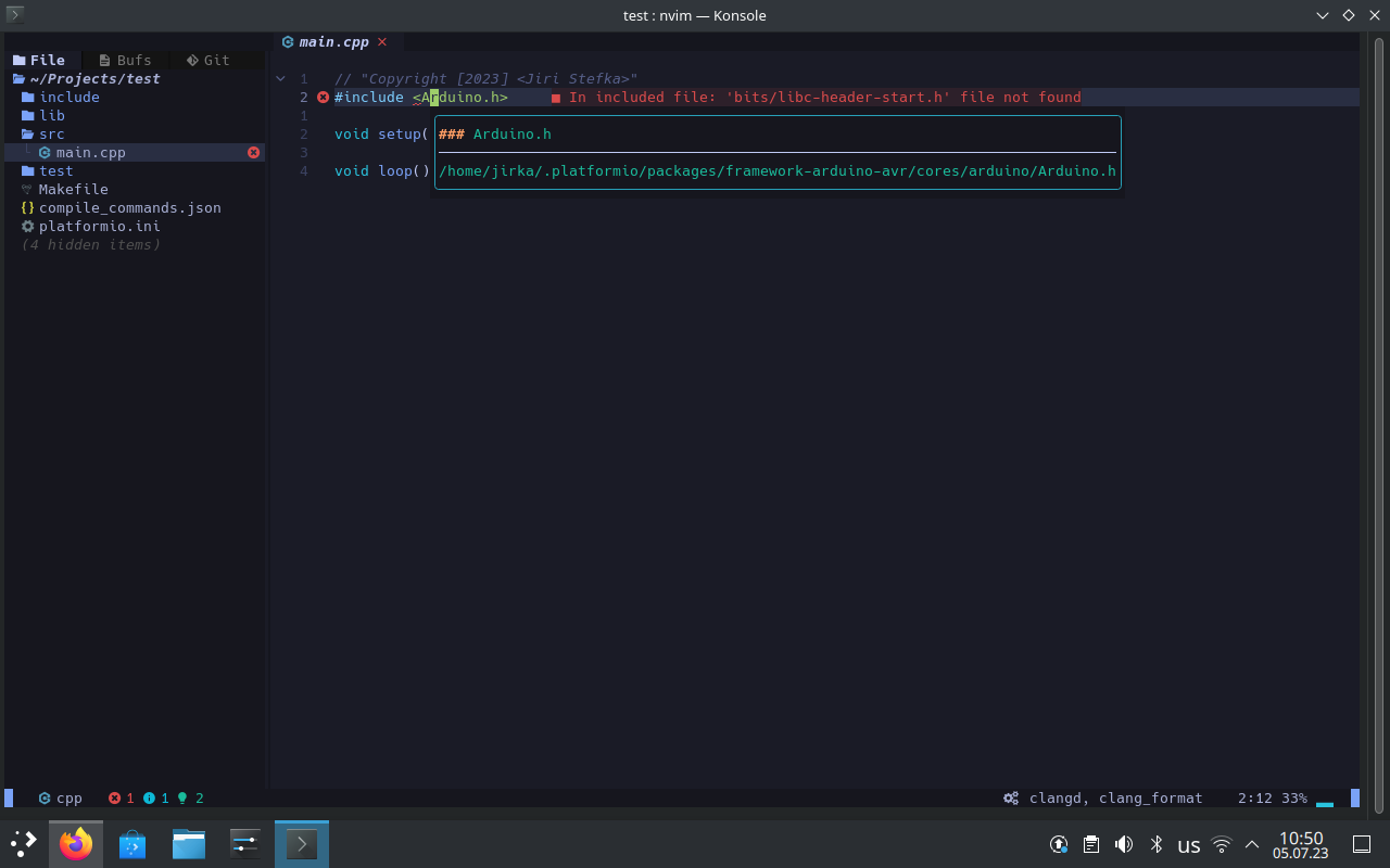

Now to the problem. I created a test project (just initialized a project for the Uno board) and then I ran pio run -t compiledb to get the compile_commads.json for ClangD (which I use in NeoVim).
The problem is with Arduino.h. It is included from the correct folder
but the problem is that Arduino.h includes stdlib.h which ClangD thinks is the system one.
This is the issue itself, but if you want to follow the file to get the issue ClangD reports it’s this: clang: 'bits/libc-header-start.h' file not found [pp_file_not_found]
I think that it’s an issue with the generated compile_commands.json
Any way to fix this? It prevents autocompletion from working.
