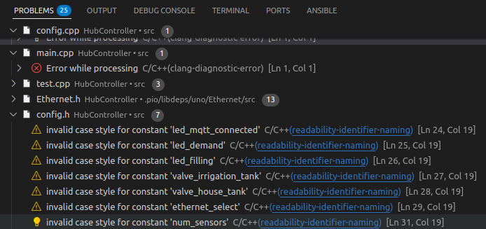

  4. I was expecting that View|Output would give me output from clang-tidy, but it doesn’t. What am I missing? Is it supposed to work like I expect?

/home/maxg/Workspaces/PlatformIO/Projects/HubController/src/config.h:29:19: warning: invalid case style for constant 'ethernet_select' [readability-identifier-naming]
    const uint8_t ethernet_select;              // Ethernet chip select
                  ETHERNET_SELECT
/home/maxg/Workspaces/PlatformIO/Projects/HubController/src/config.h:31:19: warning: invalid case style for constant 'num_sensors' [readability-identifier-naming]
    const uint8_t num_sensors;                  // Number of sensors}
                  NUM_SENSORS
Suppressed 19 warnings (19 in non-user code).
Use -header-filter=.* to display errors from all non-system headers. Use -system-headers to display errors from system headers as well.

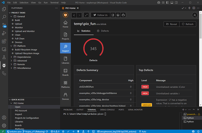

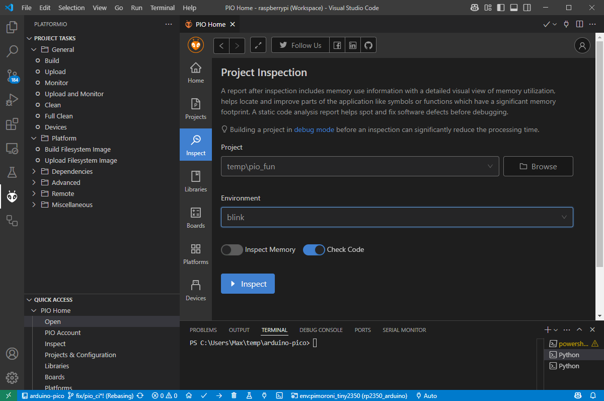

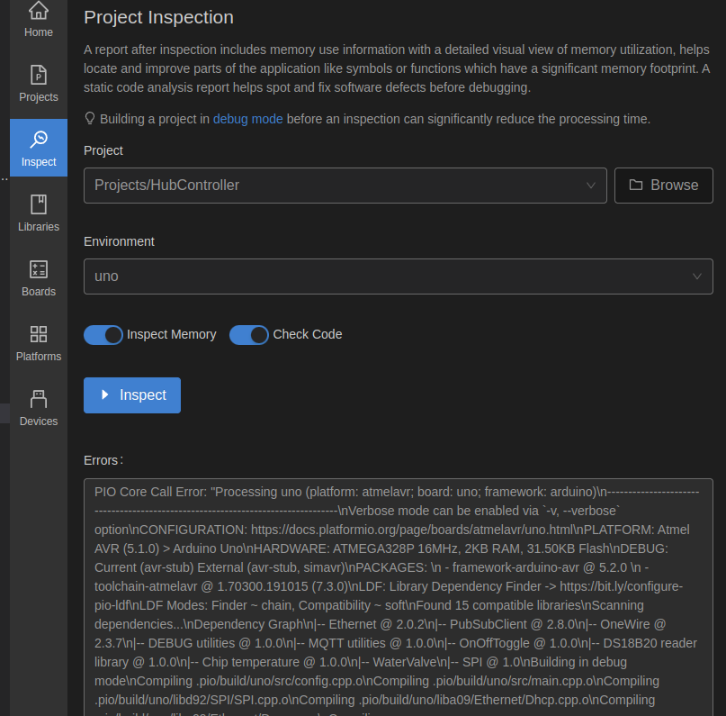

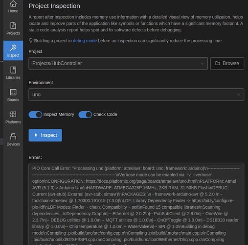

I then tried “Inspect”, but it gives me only an error window, not the nice graph in your second screenshot.
I am running PlatformIO Core, version 6.1.18 (maybe yours is different?!
Yes… didn’t know any better. I had v14 already there (maybe/must be part of Linux Mint), and updated it to v18.
Understood. (Though not too worried about it; at least ATM :slight_smile: )
Mh then something went wrong there, can you copy-paste the full output in a code block here? You might need to open up a PlatformIO Core CLI and manually execute pio check (with -v possibly to see the error better)
Sure… here it is the result of pio check -v:

I couldn’t paste the lot (62kB) as it exceed the 32kB limit.
On that note: is there a way to exclude specific directories (like libdeps) from the check?
Can you add
check_skip_packages = yes
in the platformio.ini and retry the same command. It looks like its double-defining all compiler-specific macros for the AVR target. Use pastebin.com if the output gets too large.
Good idea… pio check -v - Pastebin.com
I added check_skip_packages = yes, but it still did libdeps/…
Moved the ‘inspect’ problem to a new thread: Inspect producing weird errors and does not show graph
