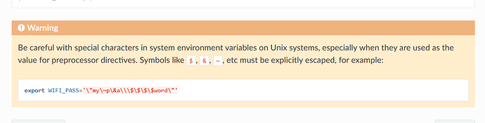

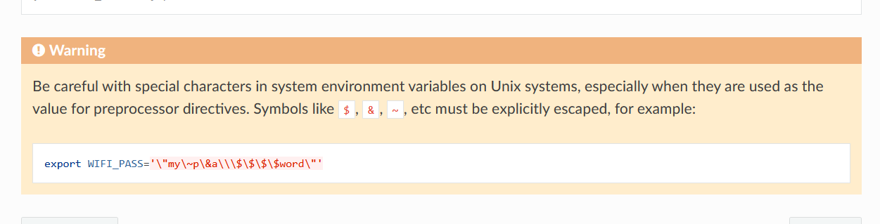

How did you escape it? The documentation gives an example
https://docs.platformio.org/en/latest/projectconf/interpolation.html
I read this several times before, and escaped this way:
export WIFI_PASSWD='\"MYPASS\(WORD\"'
Always the same error message.
If the documenation is wrong or the core has a bug, please file it in https://github.com/platformio/platformio-core/issues/.
