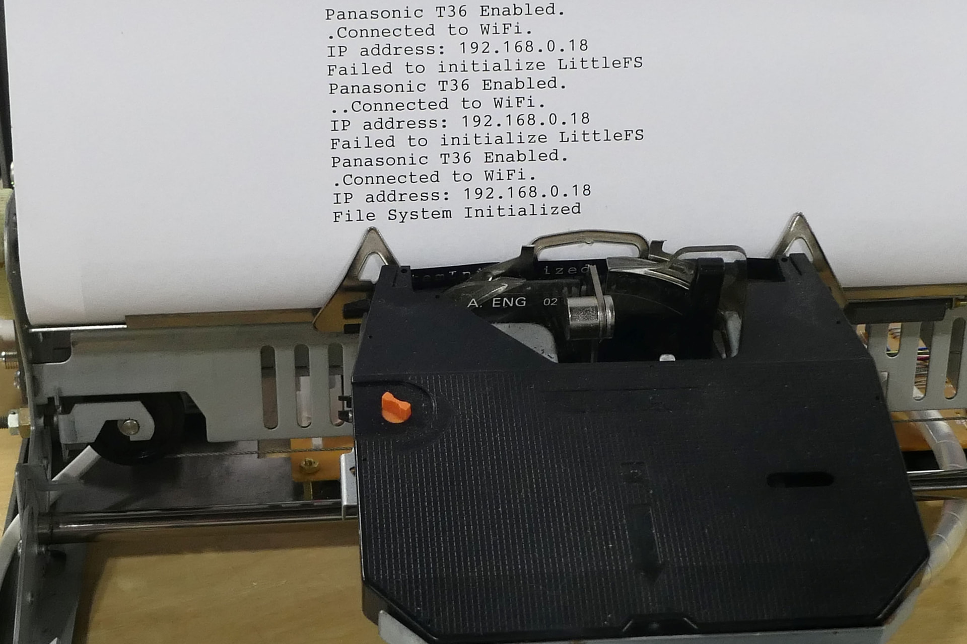

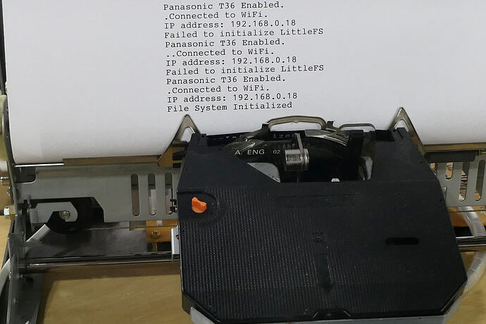

Thanks for the help. I had thought PlatformIO was using the default 4MB partition file, (the exact same partition file used successfully with the Arduino IDE) but I guess it wasn’t. I specified the following in the .ini file. I rebuilt the image. I uploaded the new image. I re-flashed the device and it worked.
board_build.partitions = default.csv
And here is the proof on my ‘91 Brother AX350. Thanks!
