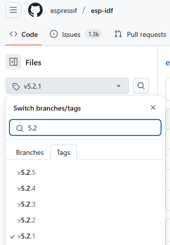

Espressif32 platform 6.5.0 is old. 6.11.0 is the latest official one. It would use ESP-IDF v5.4.1.
With your currently used 6.5.0 platform, it uses ESP-IDF 5.1.2. Which means you should use an example from the same tag or branch. https://github.com/espressif/esp-idf/tree/v5.2.1/examples/wifi/espnow .
Long story short: Consider updating your espressif32 platform (e.g. setting platform = espressif32@6.11.0
in the platformio.ini
) and version-match the ESP-IDF version that your platform uses to the example code you copy and paste from the ESP-IDF repo.
