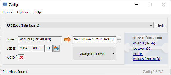

Can you please do the following:
  1. Plug in the Pico in BOOTSEL mode (BOOTSEL button pressed down during USB insertion)
  2. Take a screenshot of Zadig with the “RP2 Boot (interface 1)” selected
  3. In a VSCode terminal, execute this command and post the output
C:\Users\<username>\.platformio\packages\tool-picotool-rp2040-earlephilhower\picotool info -d
If it’s correct, it should say e.g.
Device Information
 type:        RP2040
 flash size:  2048K
 flash id:    0xE661410403705433
And in Zadig
