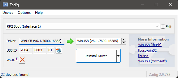

Can you please do the following:
  1. Plug in the Pico in BOOTSEL mode (BOOTSEL button pressed down during USB insertion)
  2. Take a screenshot of Zadig with the “RP2 Boot (interface 1)” selected
  3. In a VSCode terminal, execute this command and post the output
C:\Users\<username>\.platformio\packages\tool-picotool-rp2040-earlephilhower\picotool info -d
If it’s correct, it should say e.g.
Device Information
 type:        RP2040
 flash size:  2048K
 flash id:    0xE661410403705433
And in Zadig
Thank you maxgerhardt. I am sure you are sick and tired of posts like this. Believe me, if I could find an option I exhausted that I knew about I would explore it. Your help is my last wits end.
I am working on what you asked for and will have it in a few minutes.
Sigh. I REALLY HATE IT WHEN THIS HAPPENS!!!
Now all of a sudden it works. No idea why because I tried literally every option and had zero success. But now, as I tried it just one last time, it flashed it in quick order and it worked. And what I REALLY hate is that I have no idea why or what I fixed to get to this point. And I am very aggravated because it works now, with no idea why, and on top of that, I bugged you for help.
Here is what you asked for, and as I said, works now. It works. Great! So WHY am I not happy?? I mean I tried EVERYTHING! Nothing adds up here.
